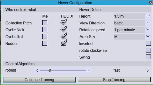

read its good to learn to hover with a slow piro, 1 rotation per minute.
if i use the rudder trim in config the heli starts tail in,turns to side on then stops.
i found in the training section a option on rotation,chose i per minute but again it stops side on.
i chose heli-x the control rudder and it also stops side on.
i have looked to see if there is a camera view or angle that might need changing but can not see one thats relevent.
any ideas?

I just tried this setting with the Specter V2 and it rotates very slowly, as expected. I stopped after 360 degrees
It might be, that by your input on aileron and elevator, you influence the rotations ...
